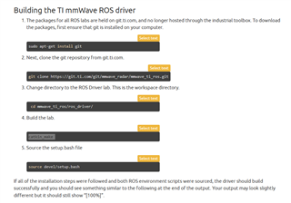

Customer try to visualize data according to TI mWave MMW ROS Driver User Guide:

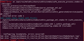

In the step of executing "build the lab", that is, executing "catkin_make",there will be an error:

This seems to be an issue with the your current ROS setup and the Python installed on your computer. ROS Melodic/Noetic does not seem to like python3, and so this does not seem to be a mmWave Sensor or its ROS driver related issue. Check here:
https://answers.ros.org/question/346359/cmake-error-at-optrossafe_execute_processcmake/
I would suggest looking through ROS forums for solutions
