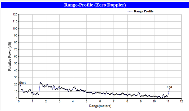

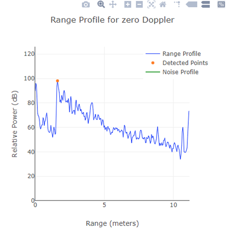

      2. TLV type2 Range Profile: I have received the range-profile and converted  Q9 arrays to real-number. Compared to what is shown on the visualizer chart, the waveform is similar but the value is small. Q9 What kind of calculation should be done after format conversion?
      And I wonder how the range profile is expressed from the actual sensor.
    • In our program
    • In TI’s ‘mmWave demo visualizer’
    Below is a function of convert ‘Q9-> real-number’
    float q9_to_float(const uint16_t q9_value, const uint16_t unFraction)
        int integer_part = (q9_value >> 9) & 0x7F;
        int fractional_part = q9_value & 0x1FF;
        // 1. Q format를 real value로 변환
        float result = static_cast<float>(integer_part) + (static_cast<float>(fractional_part) * pow(2, -(unFraction)));
        return result;
    The question is “Is there any post-process to show same with TI’s ‘mmWave demo visualizer’?”

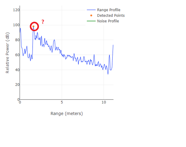

    1. How to express detected-points on the visualizer's range-profile chart? And which TLV include that information and need to calculate?

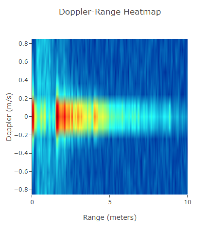

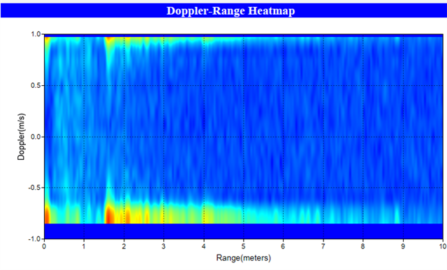

    I have received it from IWR6843AOPEVM, and plot in chart.
    But it differ with TI’mmWave demo visualizer
    • In our program
    • In TI’mmWave demo visualizer’
    The question is Is there any post-process to show same with TImmWave demo visualizer?
    1. The difference of the image between ours and TI’s
    2. how can I mapping the array indexer to real value?
    • The 2D array is consist of Range FFT size(0~255) X Doppler FFT size(0~15).
    • How to map the each indexer to real value(Range  meter and Doppler-m/s)

    2. In regards to the range profile processing, please see this similar post which I believe should provide some insight: https://e2e.ti.com/support/sensors-group/sensors/f/sensors-forum/1209769/iwr6843aopevm-range-profile-data-from-log2-to-linear-values/4564911?tisearch=e2e-sitesearch&keymatch=range%252520profile%252520does%252520not%252520match%252520demo%252520visualizer#4564911
      • How to express detected-points on the visualizer's range-profile chart? And which TLV include that information and need to calculate?
      My Apologies, I'm still investigating this inquiry. Please allow me to respond on this point within the next 24 hrs.

    3. For your range-doppler heatmap, it looks like the data is correct but it is being plotted differently. I think this is because of how the data is being stored and output from the device is not the best way to show it. Please correct me if I am wrong but it appears you are just plotting the 2D array as is without first doing any processing/rearranging?
      • The "0th doppler bin" aka the first value of each row in the 2d array corresponds to Zero doppler and as such should be plotted in the middle of the Y-axis on your plot
      • Doppler bins 1-7 will be corresponding to the positive doppler and increasing in magnitude
      • Doppler bins 8-15 will be corresponding to the negative doppler and decreasing in magnitude
    In general we do not have any documentation which covers how we are plotting the output data etc... but if you are interested, you are actually able to view the source code for the mmWave Demo Visualizer, the relevant code is located in the mmWave.js file.
