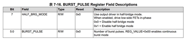

According to the datasheet, when the IO_mode is configured IO mode 0 and 1,the pulsed numbers are defined by the BURST_PULSE.
For example, if BURST_PULSE is configured 0X3F, it could send 63 pulses.
And the datasheet also describes that for IO mode 1and 0, if the BURST_PULSE=0, it could generate continuous burst pulses. But actually, when BURST_PULSE=0, it couldn't send pulse, and the PULSE_NUM_FLT status is set to 1. Please help to confirm if BURST_PULSE=0 could generate continuous burst pulses.

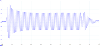

    That is correct, if the user needs to continuously needs to burst they can configure the BURST_PULSE = 0. They still need to provide the necessary signal at the IO pins in order to generate the pulses, if they just need a high count and not continuous they can also set the pulse count on the BURST_PULSE register. The TUSS44x0 GUI does not have the continuous burst function enabled but it does allow them to configure 0x3F to the BURST_PULSE register, here is a scope capture when using ox3F below:

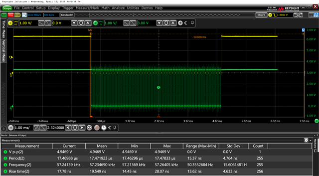

  • Hi Isaac,
     The whole curve is as following, IO1 is yellow, IO2 is green.

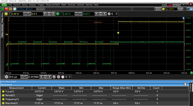

    The start curve is as this:

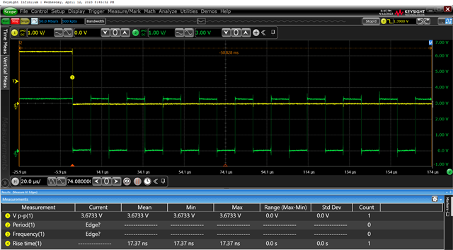

    The end curve is as this:
    And the same signal of IO1 and IO2 pin, has tried the IO_MODE=1 and IO_MODE=0,but when BURST_PULSE=0,there is no pulse generation, so I am wondering why is it ?

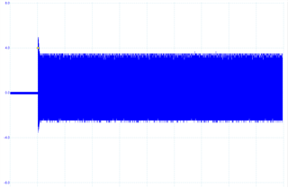

    I am still waiting for feedback on the BURST_PULSE = 0 for IO_MODE 0 and 1, but the digital designer is currently out of office so it might be a bit before we get more info. I did achieve continuous burst in IO_MODE = 2, since this actually does not take into account the value in the BURST_PULSE register.
    I included a  scope capture below, this was taken using a 5 s/div so I was bursting for about 40 seconds here.
    Although I will note that when doing continuous bursts the voltage to the transducer was reduced when compared to doing a smaller burst with fewer pulses. This is due to a capacitor that needs to be charged on the VDRV pin. I am not sure if the customers application but if the continuous burst requires a significant amount of voltage continuously sending pulses might not be the best solution.
    I found that using IO_MODE = 1 with a lower amount of pulses and essentially duty cycling the measurements allowed me to have a higher voltage because I allowed the capacitor time to charge appropriately. So in this capture below essentially I send 7 pulses, break for a 1ms then send 7 pulses again. So this is like a pseudo continuous mode.
    Below I tried a burst sending 63 pulses every 8ms, that still seemed to yield ~32Vpp swing compared to ~8Vpp when continuously bursting. If I increased the frequency of the bursts I would still see the 63 pulses but the voltage was just reduced.

  • Hello Kailyn,
    Thanks for the patience here. I just got a response from the digital design team. The continuous burst option is only available in IO_MODE = 2 for the TUSS4440. This is not an option on IO_MODE = 0 or 1.
