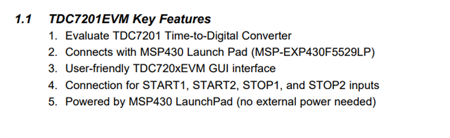

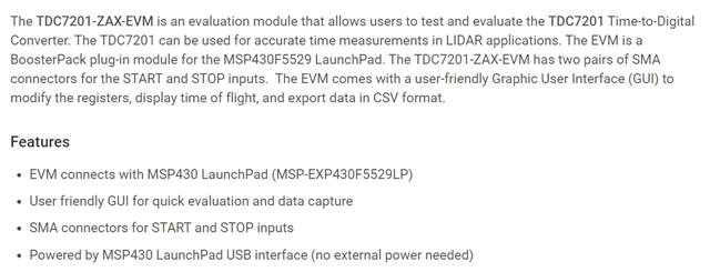

  • Hello Charles,
    Sorry for the frustration on this, the User's guide mentions it in section 1 under key features as shown below and we also mention the MSP in the EVM description. I apologize if it wasnt obvious and if you have any feedback on how we can make this more apparent please feel free to send that over.
    To get started as soon as possible without writing any firmware would be purchasing the MSP-EXP430F5529LP found here: https://www.ti.com/tool/MSP-EXP430F5529LP
    This will let you interface with the GUI to setup the device and  make measurements using the TDC7201. If you have any questions once you get the device please let me know and I would be more than glad to help.
