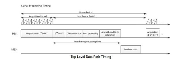

    Please see below the frame structure.
    (1) If the new frame is triggered earlier but the Acquisition Period has completed than there may not be sufficient time to process the data coming during next frame.
    (2) If the frame is triggered earlier and the Acquisition Period has not completed than the RF front end may generate an error.
    Are you considering (1) or (2) ?
    Thank you
    Cesar

    Thank you for the reply. Assuming that the Acquisition Period has completed in scenario (1), I would like to ask a few more questions regarding the hardware triggering mechanism.
    1. Is the trigger interrupt serviced by the RF front-end (BSS) or DSS? What time of interrupt is this (hardware/software/etc.)?
    2. Does the BSS perform any configurations for the new frame in response to a hardware trigger?
    3. If the trigger is received in the middle of the inter frame processing, does processing resume right where it left off before the trigger interrupt?
    4. Is it possible for any BSS configuration corruption in scenario (1)?
    Thank you,
    Norman
  • Is the trigger interrupt serviced by the RF front-end (BSS) or DSS? What time of interrupt is this (hardware/software/etc.)?
    The trigger interrupt is serviced by the BSS
    No, the BSS will only trigger the frame
    No, there will be Frame Start and Chirp available interrupts triggered from BSS to DSS. The application will decide how to handle them. If they are not processed the data is lost.
    NO, the BSS configuration will not be corrupted
