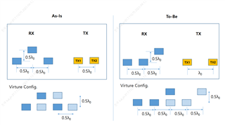

Hello TI expert!
I will design a antena so, could you check it?
Does it matter if I use the current SDK as is?
I use the SDK Version: MMWAVE_L_SDK_05_01_00_04
Thans.
With this antenna layout, you may not be able to estimate the incoming angle of arrival if it is greater than about 25 degrees in the azimuth because the upper right antenna is more than half a wavelength away from any other antennas. With the original antenna, you will not have this problem. With the proposed antenna too you will need to modify the processing chain to account for the antenna positions.

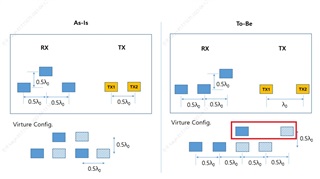

Hello
Thank you for your kind explanation. I have another question because I don't understand one thing
1. You said that 'in the azimuth because the upper right antenna is more than half a wavelength away from any other antennas. '
the upper right antenna means the antenna I circled in the picture below?

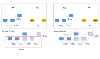

2. I think the antenna where azimuth and elevation are calculated looks like the picture below
Yes
The antennas you're circling with the red box here are more than 1/2 of a wavelength apart (they are 0.707λ apart by the Pythagorean theorem)

Hi Nathan,
I am sorry, that I don't make my intention clear enough. My question is, is it possible to use more than 1 array for the same axis (for this example,the azimuth, with one array is 4 elements, while other is only two elements ) in iwrl6432?

Hi Wolfgang,
If what you're asking is if the virtual antennas can be at different locations on both the X-Axis (azimuth) and Z-Axis (elevation) then the answer is yes. This is how our IWRL6432BOOST EVM is designed.
