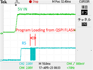

When I checked the pin status from reset release to completion of program loading with an oscilloscope, it was as follows.
・P4 Fixed high level (3.3V)
・R3 Fixed high level (3.3V)
・R4 HIGH/LOW toggle during program load
・R5 Fixed high level (3.3V)

    Using the TIDEP-0091 sample demo and IWR1443BOOST, I observed the R4 and R5 terminals.
    Figure 1 shows the waveform of the R5 pin.
    Figure 2 shows the waveform of the R4 pin.
    Q1. Some signal is output to R5 while the program is being loaded from the QSPI FLASH Memory.
    When I zoomed in on the waveform, it seems that a UART-like signal is being output.
    What are the pinmux settings for this period? Is it MSS_UARTB_TX(MSS_LOGGER) ?

    Figure 1. R5 pin waveform

  • Hi Hiroyuki,
    Yes.
    1. R5 is MSS_UARTB_TX(MSS_LOGGER)
    2. R4 is  BSS_UART_TX
