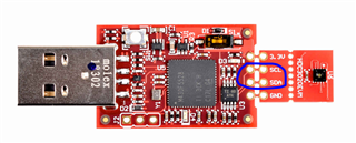

got a HDC3020EVM from mouser, work well before we tested at tempreture/humidity chamber in 60 degree/ 90% humidity condition yesterday( before run this condition, we did other condition like 20/40 degree/ 90% humidity), USB disconnect and the HDC3020EVM 1.0.5 software cannot connect the board anymore , winodws can not detect the USB device . we can see a red LED always slowly blink.
so how to make it work again ?

    If the red LED D4 is blinking this means that the USB interface is powered but not connected to the HDC3020. The green LED D3 appears to be illuminated in your photo, and this indicates that the VDD net is powering the HDC3020. The behavior you're seeing may have been caused by an unintended short or ESD damage to the board.

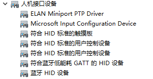

    Can you confirm if the EVM shows up in the Windows Device Manager under Human Interface Devices > USB Input Device?
    Nicole
  • Dear Nicole:
    No, I can not find the USB input device any more after plug in the EVM .
    and I checked the HDC3020 interface to MSP MCU interface 3.3V/SCL/SDA/GND using multimeter, it is seemed no short .
    so is it possible we can check it is MCU side (USB side) issue or HDC3020 I2C part issue step by step ?

    To debug HDC3020 I2C communication you can probe the SCL and SDA lines while trying to connect to the GUI, to verify if the HDC3020 is responding to host commands.
    I have sent you a message to coordinate sending a replacement EVM.

    before I refresh the firmware, I checked the USB HID input device after plug in the USB2ANY board , it is work now .
    so the only explaintion for this issue maybe moisture brought some trouble for the USB2ANY part when the board working at high tempreture and high humidity(60 degree and 94% around 0.5 hour), after return to dry envirement some days it is recovered .
    anyway it is happy to find the board work again and thans for your support .
