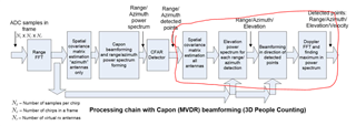

  • I am now referring to the guide you provided, but I'm not sure yet, so I'll ask the question again.
    According to the People Tracking and Counting Reference Design guide, the overall detection direction is as follows.is as follows.
    I have a question about the part marked in red in the processing chain in the picture.
    More details are organized on pages 12 and 13 of the guide, and I have a few questions here.
    1. Xkcr is the clutter removed signal. So, the corresponding data is 3-dimensional data, rangebin x chirp no x virtual antenna (using 12), so the data is 3-dimensional data, ram I right??
    2. To obtain the elevation, the capon algorithm that first obtains the range angle map is used. Through the covarince matrix, a two-dimensional array of range/azimuth specturm Pna is formed. Here, the target distance and azimuth angle are extracted through cfar. I know. However, if you look at the elevation processing chain, it says that it calculates the spatial covariance matrix, but I don't understand how to get the covariance matrix of the detected points.

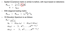

    3. This is a question related to number 2, and the process is summarized as a formula on page 13 as follows
               Here Xkc is what shape does the matrix have? And I don't understand where the location information of the target detected through cfar is used. Xkc             is 3-dimensional data, isn't it 3-dimensional data consisting of range bin x chirp number x virtual antenna? Angle information is not included in this               signal. How is the result detected in the range azimuth map used? Are only distance values ​​used for elevation measurements?

  • Xkcr is the clutter removed signal. So, the corresponding data is 3-dimensional data, rangebin x chirp no x virtual antenna (using 12), so the data is 3-dimensional data, ram I right??
    The cluttered-removed signal is still three dimensional yes.
    • To obtain the elevation, the capon algorithm that first obtains the range angle map is used. Through the covarince matrix, a two-dimensional array of range/azimuth specturm Pna is formed. Here, the target distance and azimuth angle are extracted through cfar. I know. However, if you look at the elevation processing chain, it says that it calculates the spatial covariance matrix, but I don't understand how to get the covariance matrix of the detected points.
    The covariance matrix of the detected points is created by taking the outer product of the data at a single range/azimuth location over all the different elevation antennas. This will yield the covariance in the elevation direction.
    I would expect X_kc, as the input to the elevation estimation, to be a 4x4 matrix that corresponds to the a single range and azimuth bin over the 4 elevation antennas. The location information of the target through cfar is used so we don't calculate the elevation spectra for every single range/azimuth location, just the ones that have been identified through CFAR. I don't believe this would be used for the range/azimuth map. The elevation measurements use the difference in returns over different antennas placed at different elevations to estimation the target elevation.

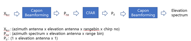

  • I think my explanation was lacking. I'll make up for it and ask you three questions
    1. Do Pna circled in red and range/azimuth power spectrum mean the same thing? Then the shape of Pna is (range x azimuth spectrum), right?
    2. If cfar is used in the range/azimuth power spectrum, one value for azimuth and one range comes out. Are azimuth and range points also utilized to obtain the elevation spectrum here?
    3. It is said that a covariance matrix is ​​obtained based on the results of Xkcr and cfar with black squares. Xkcr is (virtual antenna x range bin x chirp no) 3d matrix. So, I know that the range point resulting from the cfar should be put in the range bin of the 3d matrix, but where do you put the azimuth point to find the covariance?
    • Do Pna circled in red and range/azimuth power spectrum mean the same thing? Then the shape of Pna is (range x azimuth spectrum), right?
    Yes I believe so. See figure 3 for a full diagram.
    The elevation spectrum must be generated by holding the range/azimuth constant.
    The azimuth is held constant as well. This is what is meant by "performed at the azimuth of each detected point"
