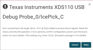

Hello, Nate.
EVM is connected to MMWAVEICBOOST.
And switch is configured to BT PROGRAMMING mode.
(S1.1 - ON, S1.2 - ON, S1.3 - OFF, S1.4 - OFF, S2.1 - OFF, S2.2 - OFF, S2.3 - ON)
XDS110 port is connected.
Error is occurs when trying to flash.
JIYEON.
Hi Jiyeon,
This is not what is recommended in the post I linked. It says to connect to the CC2642, which is on the AOP directly (no MMWAVEICBOOST needed), and that you'll need to use the 10 pin JTAG header, which you have not done. Please read the post I linked and attempt with the method described.
