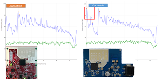

AWR6843: I would like to inquire about the issue of short-range detection of the AWR6843 antenna
Part Number: AWR6843
Hi~
I compared my sample with AWR6843ISK using TI's mmWave DEMO Visualizer.
However, as shown in the figure below, a high signal is sensed within about 1m.
Please check why this waveform can occur.
※ cf : Antenna is applied in the same way as AWR6843ISK, and the measurement environment and SW(out_of_box_6843_isk.bin) are the same.
