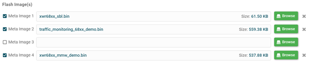

We've loaded the xwr68xx_sbl.bin, our traffic monitoring project, and the xwr68xx_mmw_demo.bin as the base code that we want the system to revert back to as follows:
If we just load the xwr68xx_sbl.bin file, then we get a count down from 90 on flashing a new binary image in our terminal screen.  If we load the sbl.bin and the .bin for Image 4, it appears to go directly to Image 4, without giving us a chance to send an upload to the board (no countdown).  We connect the board to the USB, and then connect the terminal software within about 3-4 seconds, but a CR/LF to the device indicates we're already at the CLI response, and the version command confirms the .bin we're running.  If we load all three, it appears to go directly to Image 2 before giving us a chance to send an upload to the board.

    First, I want to make you aware that each offset for the images is 512KB. Therefore some modifications may have to be made to fit the images > 512KB. The one in the second slot in the screen grab will be ok because it will flow into slot three. See this e2e thread of a reset customer using SBL: https://e2e.ti.com/support/sensors-group/sensors/f/sensors-forum/1210724/iwr6843aop-3dpc-backup-image-meta-image-4-slot-overwrites-sbl-image-utility

    Was able to get everything running this morning.  Lowering the SBL_AUTOBOOT_COUNT worked as expected.  However, I needed to modify SBL_METAIMAGE_OFFSET to (512U * 1024U) from the 256U setting in order for it to find the flashed meta image2.  The additional time that it takes for the bootloader (and a short delay to allow for selection of a new image) required that we make some timing adjustments in other parts of the system - but with that completed it appears to work as expected.  Thanks for all your help.
