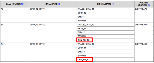

A customer would like to configure PinMux using Sysconfig Tool.
However it seems be not available for 1843AOP package type as below.
If Sysconfig Tool does not support AWR1843AOP, Please help to configure CANFD pin with A4 and B4 as below.

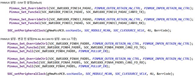

They tried to change pinmux setting as below. But it does not work yet.
Please let us know how to configure A4 and B4 pins to CAN_FD_XX properly.
