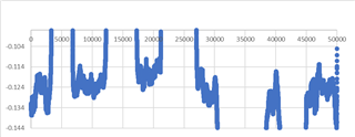

I wish to use this magnetometer for an application where it will be approached by a neodymium magnet of type n52.
I have tested exposing this magnetometer to the n52 magnet and it seems that the magnetometer loses its calibration. Indeed, I compared the raw magnetometer values before and after the exposure and I observed an offset drift on the Y and Z axes.
What is the maximum magnetic field strength that must not be exceeded to maintain the metrological characteristics of this sensor?
I did not find this information in the datasheet, nothing is mentioned in the Recommended Operating Conditions section.
Is anyone have an idea?  Thank you.

  • Hi Scott,
    I was testing the TMAG5170 with two stacked magnets reference 9161 from Radial Magnets. These are flat cylindrical magnets that I approached at 2 cm of the sensor. Through simulation, I found that the maximum field of the magnet at this distance is 0.5 Tesla.
    The offset change that I observed on Y axis is of -15 uT and on Z axis is of -24 uT.

  • Hi Scott,
    Yes, to see if an offset drift appears after an exposure to my magnets, I took the average of 9999 data for each record. I compared the average of raw values and I converted it into uT. The magnetometer is set to 32x - 0.4Ksps (3-axes) sampling mode. I set the range to ±25 mT.
    I observed a drift on the two magnetometers that I tested. Both were stable over the average of the pre-exposure records (during a week).
    I can also confirm that the PCB was not disturbed during the test.

  • Hi Scott,
    I put the files on another file sharing service : https://filesender.renater.fr/?s=download&token=f6d56bf1-2e34-4794-b0cc-ef2a8275e061.
    In my tests, I have applied several times the field. It is at the time of the first exposure that I observe an important drift. On the following exposures, the averages are less stable from a record to another.
    This is a plot of Z axis averages. In phase 1 of my experience, the magnetometer is not exposed to magnets. The record following the one with the red dot is the first one after an exposure. In phase 2, there is a succession of before and after exposure records.
    And this is the same plot for Y axis :

  • Celement,
    Thank you for sharing these plots.  I am not able to use external file sharing services for security reasons.  I see the shift you have indicated, and am reaching out to our validation team to find out if they have seen anything similar during their testing.
    To be sure I understand, at the first exposure to a strong magnetic field (>500 mT) this shift occurs, but upon subsequent exposures there is not as dramatic of an effect? On these devices are you able to apply a similar field with opposite polarity and confirm whether there is any hysteresis in this response?

  • Hi Scott,
    I applied the same field with opposite polarity and this has almost cancelled the offset drift.
    The cause may be the ferromagnetic materials contained in the Arduino board. I will try next week to move the magnetometer away from this board.

  • Hi Scott,
    Thank you for your feedback from the validation team. I have remade my test setup as I planned before. The arduino board is far away from the magnetometer and I was careful to make sure that there were no materials near the TMAG5170.
    I will take measurements over several days and I will keep you informed of my results.
    Clément
  • Hi Scott,
    I made a series of recordings with my new setup and I don't see any offset drift.
    So this sensor is good for my application. The environment of my first experience was causing problems.
    Thank you for your answers,
    Clément
