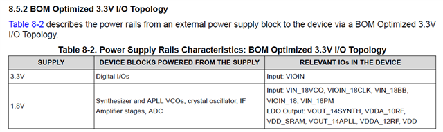

IWRL6432: How to enable BOM-optimized mode of IWRL6432?
Part Number: IWRL6432
Hi TI expert,
 As IWRL6432 datasheet says, it supports BOM-optimized mode to save one external 1.2V regulator. But how does the chip switch from external 1.2V to internal LDO instead? Will the chip automatically detecting the voltage to switch to internal 1.2V or need to do some config? Or just need to connect the supply circuit like datasheet mentions?
