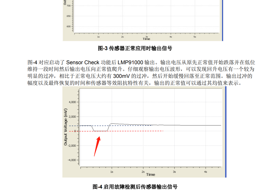

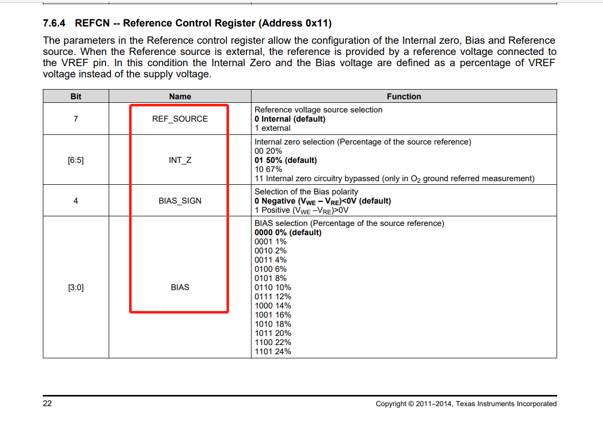

1. Modify the REFCN register (with Figure 1), which parameter is modified? REFCN has four parameters (Figure 3): REF_SOURCE, INT_Z, BIAS_SIGN, and BIAS.
2. Now the parameter setting REFCN=0x80 when the sensor is working normally, how much should it be changed when starting fault detection?
3. Is the recommended duration value of low level about 0.5 seconds? (Picture 2)
