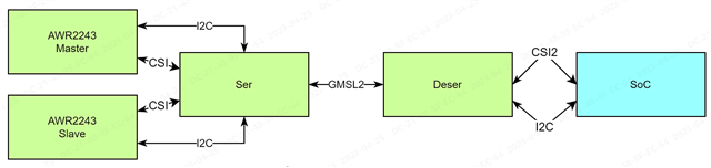

There are two awr2243 cascaded, connected through the I2C bus and the deserializer, then connected through the GMSL2 line to the deserializer on the domain, as shown in the figure below:
Porting the mmWaveLink_Cascade_example from the mmWave_DFP_02_02_04_00 DFP package to the Linux OS to run the demo program, the 2243 parameters can be initialized and configured normally. However, in the query IRQ interrupt thread, the initialization process fails if you include code that reads other device registers via the I2C bus (such as reading the value of the plus-serializer device id register). If the read-in-the-serializer device id register value code is masked out in the interrupt thread, initialization is ok.
The customer is trying to disconnect the gmsl line from the domain control board and have the hardware set the i2c scl, i2c sda, host IRQ, reset, ground signals fly to the respective GPIO for the domain control. Also disconnect the 0 ohm resistor connected between master's i2c SC, i2c sda, IRQ, reset, 4 signals and the deserializer. And configure the appropriate pins in the kernel dtsi to run the demo program. Include reading other device register codes via the I2C bus in the Query awr2243 IRQ Interrupt thread.
The behavior is the same as using gmsl to connect to a domain control board, so the problem should be independent of the serializer and the gmsl line.
What is the possible cause of an iRQ state fault that causes the initialization to fail if another device on the I2C bus is accessing I2C during the initialization of configuration parameters? And how to fix it?

    The customer is wondering if there are other devices accessing the I2C bus while the awr2243 parameters are being configured by Host via I2C, is it possible that the parameter configuration process will fail? It should be a firmware or hardware issue, right?

    During the configuration process I2C is used for communication between host and awr2243.
    If the I2C connection is corrupted the configuration will fail and the firmware running on awr2243 will not be able to notify the host.

    What do you mean by "the I2C connection is corrupted"? If no other device is accessing i2c during the awr2243 configuration, the demo configuration is fine and waves can be emitted. It should be related to the software and firmware of the awr2243?

    I meant if there is a physical corruption on the I2C bus
