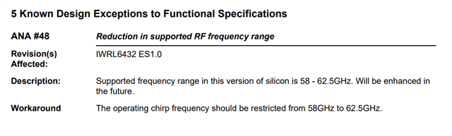

Dear TI R&D guys,
I have been helped to develop IWRL6432 custom board.
Now I have other question related in IWRL6432 specification.
I put in below configuration to my board which is just example for this question.
sensorStop 0
channelCfg 7 3 0
chirpComnCfg 8 0 0 256 4 50 0
chirpTimingCfg 6 63 0 50.1 60
frameCfg 2 0 500 64 150 0
guiMonitor 2 1 0 0 0 1
sigProcChainCfg 16 8 1 1 4 4
cfarCfg 2 8 4 3 0 8.0 0 0.5 0 1 1 1
aoaFovCfg -60 60 -40 40
rangeSelCfg 0.1 12.0
clutterRemoval 1
compRangeBiasAndRxChanPhase 0.0 1.00000 0.00000 -1.00000 0.00000 1.00000 0.00000 -1.00000 0.00000 1.00000 0.00000 -1.00000 0.00000
adcDataSource 0 C:/ti/mmwave_lp_sdk/examples/datapath/common/testBench/major_motion/adc_data_0001_CtestAdc6Ant.bin
adcLogging 0
lowPowerCfg 1
factoryCalibCfg 1 0 40 0 0x1ff000
mpdBoundaryBox 1 -1.5 1.5 0 3.8
sensorStart 0 0 0 0
Then, an error message was shown like this.
By calculating in estimator, End Frequency is over 62.5GHz.
I tried several times to check this. And I find out download is succeded while "End Frequency" is set only less 62.5GHz.
According to its datasheet, It has 57~64GHz bandwidth coverage. However, it dosn't seem to be.
I wonder whether that is just a problem of SDK or It can be used full coverage In the future.
