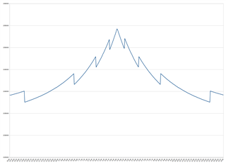

While it generally works fine, I get jumps in the output signal when moving towards and away from the target.
To have precise movement I mounted the board to a 3D printer.
The following diagram shows the output values when moving from 15 to 4 and back to 15 mm.
This is very reproducible.
I tried also horizontal movement over a slanted piece of metal to ensure that it is not a mechanical problem of the Z-axis.
I also moved it by hand, and while the output was quite shaky, the jumps were still visible.

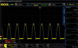

    >>Can you take an oscilloscope capture of the sensor waveform for scenarios around the result jumping?
    I tried to, but I was not able to see anything useful as these jumps are quite small in relation to the absolute frequency.
    I might need to try again...

    Aside from the frequency change being minimal, was there any odd behavior on the sensor amplitude?

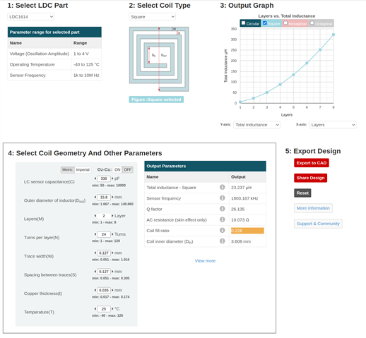

    Additionally, what is the sensor design you are using? Can you share a screenshot of your webench design?
    Justin Beigel
  • Hi Justin,
    No, there were no visible jumps in amplitude or waveform changes.
    Sure, here we go....

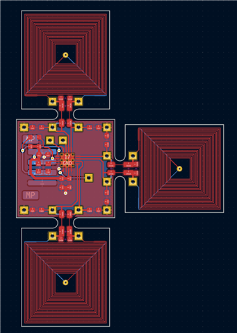

    Thank you for the additional information. I am still looking into what could be causing this but in the meantime, can you depopulate the capacitors on two of your sensor coils you are not using and then rerun the test? This would be a good way to see if there is any coupling between them in your system.
    Justin Beigel
  • Hello Justin,
    I cut away 2 coils completely as the board is designed for that.
    Sadly that did not make a difference.

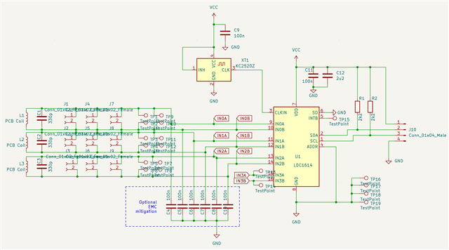

  • Here is the schematics
    Please note:
    Originally I did not populate the EMC capacitors. Later I populated 12pF. This made no difference.
    So please ignore the value of 100nF for them.
    All the connectors and test points in the INxA/B lines are not physical connectors, these are pads on the PCB to allow cutting the coils and attaching them in different ways.
    The 330pF capacitors are populated close to the coil, not on the other side of the cut away slots.

  • Hello Justin
    I really have to apologize that I wasted your time.
    It was an immensely stupid software bug that I overlooked dozens of times!
    I had a typo where I combined the DATA registers into a 32bit value.
    Thanks for you efforts.
