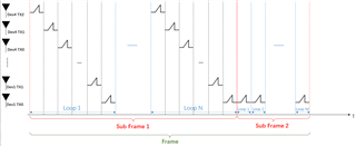

The following question is related to programming an advanced frame config in cascade mode on the AWR2243 radar devices.
My advanced frame has only 2 subframes (out of a maximum of 4). The first subframe has 12 chirps per loop, 64 loops per burst, 1 burst, and 1 burst loop. The second subframe has 1 chirp per loop, 64 loops per burst, 1 burst and 1 burst loop.
I am running LUA scripts using the shell in mmWave Studio, and calling ar1.AdvanceFrameConfig_mult() to setup the advanced frame. I believe this function programs appropriate values in AWR_ADVANCED_FRAME_CONF_SB (page 95 of Radar Inferface Control Document).
My question --

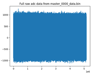

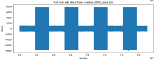

When I take captures and inspect the ADC data from master/slave .bin files, I get invalid (= +/- 7710) between consecutive frames, as shown below.
Any ideas what could be causing this? Please see the attached code I am using (.lua saved as a .txt because I am unable to upload lua files for some reason).

    -- Advanced Frame Configuration for MRR
    -- TDM subframe duration = 18.432ms
    -- Burst subframe duration = 1.536ms
    -- inter-burst time >= 50us, inter-subframe time >= 100us,
    -- Since we have 1 burst in each subframe, we just use 100us (the min upper bound)
    -- for calculating burst and subframe periodicity.
    -- SF1 (TDM) periodicity calculation:
    -- 18.432ms + 100us = 18532us = 18532000ns,
    -- dividing by 5ns (each LSB - refer to RCD/ICD page 98), we get
    -- SF1 burst periodicity = SF1 subframe periodicity > 3706400.
    -- Rounding up to 3796500 = 18.9825ms
    -- Similarly, SF2 (Burst) periodicity calculation:
    -- 1.536ms + 100us = 1636us = 1636000ns,
    -- dividing by 5ns, we get
    -- SF2 burst periodicity = SF2 subframe periodicity > 327200.
    -- Rounding up to 400000 = 2ms

  • Hi Jitendra,
    Yes, the default Cascade_Configuration_MIMO LUA script provided in the Studio installation works fine in terms of capture and plot. Please see the below ADC data -- we don't see any gaps between frames.
    I've modified this default script to transmit advanced frames but I see gaps between frames, so I am not sure if I am missing any steps. For reference, this is the MIMO advanced frame scheme I am trying to achieve:
    There are also a bunch of parameters in ar1.AdvanceFrameConfig_mult that I don't know what they mean. Typing "help ar1.AdvanceFrameConfig_mult" into the LUA shell does not provide much clarity. For example, what are "Clone SubFrames" and "Num Of Chirps in DataPacket" ?
