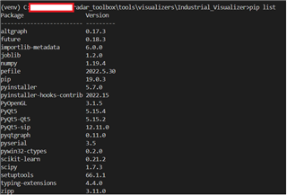

  • Can you call pip list to see if the libraries are there now? You should also see them in the venv directory you've created as folder names.
  • All the pip lists were present and the folders are present in the venv directory as well. No launch still.

  • All versions are identical to those that are listed under the visualizer pages, as well, the python version says 3.6 on the page, but I am using 3.7.3 as you suggested earlier. I more concerned that the error above is happening only on of my computers, and not the other. Only one with a discrete card works properly, but I do not have access to the radar sensor on the home computer.
    The error above mentioned is still occurring, I'm going to give it one last go and reinstall all packages, and maybe even the radar toolbox, mmwave stuff, etc.

  • altgraph 0.17.3

    This is my pip list above.
    The console from above that was showing 3.7.9 was showing a previous python from another user that used this laptop, which has since been uninstalled.
