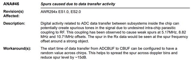

Hi Experts
As for the below statement in eratta ANA#46, we can mitigate the spurs in 5.17/8.82/10.71M by applying a random value across chirps.
In my understanding, it can be implemented by adding a random delay before calling CBUFF_triggerFrameStart & CBUFF_triggerChirpAvailable when SW session is used.
But how to configure the start time of data transfer from ADCBUF to CBUF when HW session is used?
We can not adjust when chirp_available event is generated by AWR2944.
