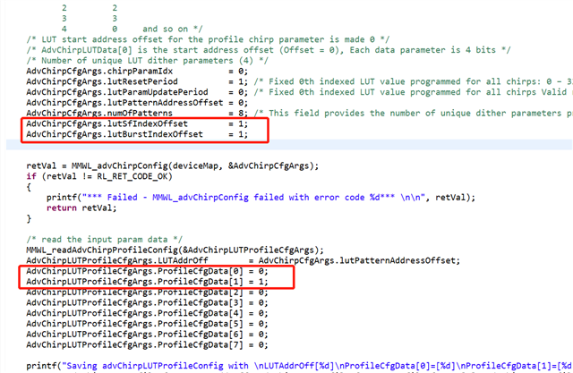

When i use the advance chip function of AWR2243,  I set two subframes and my setting just as below
Then i  find that i can get two subframes and one is used profile0 and another used profiled1 in SA
My question is that if i want to set four subframes ,and i set the four subframes in "advance frame " API
How can i set the LUT addresss of the four subframes for different profiles?
    So, my understanding of the question is that you need to use different profiles for different subframes. A similar implementation as above will work in that case.
    The LUTAddOff can be assigned the same value as in your current implementation.
    Let me know if you had a different question.
