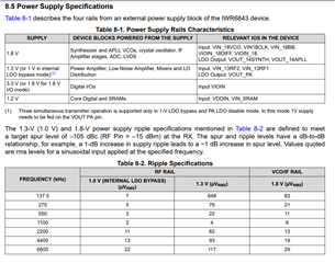

We are using a 5V, 7A Mean power supply to power MMWAVEICBOOST and IWR6843 via the barrel jack connector.
On this 5V rail, there are other components:
1.) Relays
2.) CC3220S
Do we need to isolate the supply for the MMWAVEICBOOST board and IWR6843?
