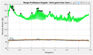

This is a follow on to this post (MMWCAS-DSP-EVM: Range / Doppler Issue with provided Matlab Scripts - Sensors forum - Sensors - TI E2E support forums) where a range & doppler ripple was identified as a hardware defect in the cascade DSP board. I have a new DSP board and am seeing the same issue. Are there other troubleshooting approaches you can recommend?
With the previous board I walked through the initial setup process several times in the hopes of fixing a missed or incorrect step to no avail.

  • Can you walk me through how to do single chip measurements with the cascade device? I tried to several months ago on the original device but couldn't succeed, which I ended up blaming on the hardware after being told the hardware was faulty. I have tried again by setting the device map and mode list as follows:
    >>dev_list = {1, 2, 4, 8} -- Device map
    >>RadarDevice = {1, 0, 0, 0} -- {dev1, dev2, dev3, dev4}, 1: Enable, 0: Disable
    >>cascade_mode_list = {0, 0, 0, 0} -- 0: Single chip, 1: Master, 2: Slave
    but when I attempt to process the data in Matlab I receive the following error:
    >>paramFile= C:\ti\mmwave_studio_02_01_01_00\mmWaveStudio\PostProc\Cascade_Capture_one_chip\Cascade_Capture_one_chip.mmwave.json
    >>Unable to perform assignment because the left and right sides have a different number of elements.
    >>Error in parameter_file_gen_json (line 100)
    >>TxChannelEnabled(iconfig) = channelID;
    >>Error in cascade_MIMO_signalProcessing (line 81)
    >>parameter_file_gen_json(dataFolder_test, dataFolder_calib, module_param_file, pathGenParaFile, dataPlatform);
    For your other questions:
    - The ripples appear for all sample rate, chip rates, slopes, durations, etc.
    - The following is an example of the radar return with a corner reflector at 2 meters. As you can see the stock signal processing calculates the distance to be ~8 meters and the ripple is clearly visible in range and azimuth.

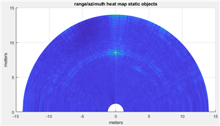

  • Kaushik,
    I dug into the assignment mismatch today. I'll try to tackle the 2d FFT of a single device tomorrow.
    When post-processing my attempt at a single chip collection Matlab hits an error in line 100 of 'parameter_file_gen_json.m'.
    TxChannelEnabled(iconfig) = channelID; >>TxChannelEnabled is a 1 x 12 array of zeroes, iconfig equals 1, channelID is a 1 x 2 array [1 12]
    Looking at the same line using all four chips TxChannelEnabled is a 12x12 array with ones along the diagonal, channelID is a double equal to the position of the one for the row given by iconfig (ie. when iconfig is 3 the one in row 3 of TxChannelEnabled is in position 10, so channelID = 10).
    params_chirp.NumDevices = 4 in the single chip processing. I'm that comes from the number of "mmwaveDeviceId" instances in the *_mmwave.json file. Is the json file generated from the configuration sent to the cascade radar? If so, why are there four mmwaveDeviceId instances in the json file when the lua only only has the first device being enabled (RadarDevice = {1, 0, 0, 0} -- {dev1, dev2, dev3, dev4}, 1: Enable, 0: Disable) and all devices set to single chip (cascade_mode_list = {0, 0, 0, 0} -- 0: Single chip, 1: Master, 2: Slave)?
    The lua code is fairly heavily paired down. I only have three tx chirps enabled and commented out all slave device related code. I am pasting the entire modified file below.

  • I grabbed the raw data, radar_data_RXchain, from line 87 in <installation_path>\4chip_cascade_MIMO_example\modules\calibration\@calibrationCascade\datapath.m and ran it through a  2d range/angle function only using radar_data_RXchain(:,:,1:4,1) which should be Tx antenna 12 and Rx antennas 13 through 16 all from chip 4. Results are below.

    • From the range-angle plot you have shared, it looks like the ADC data itself is spurious and the post processing did not cause anything here.
