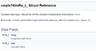

According to the mmWave SDK, the Azimuth Static Heatmap is saved in the type of cmplx16ImRe_t.
And the document goes on to show that cmplx16ImRe_t is saved in int16_t.
My question is shouldn't the imaginary and real values of the heatmap a type float?
Thank you

    Why do you think the real/imag values need to be a float? They may be int16's saved in a Q7/Q9 format, or something similar to allow for decimal values while preserving the uint16_t type size.

    If that is the case what is the exact Q format for the Azimuth Static Heatmap?
    I also looked into the SDK documents, is the length of the data in 16 bit due to the size of the ADC?

    As Nathan said, I would question your assumption about why the heatmap value would be a float. That being said, on closer investigation, I do not believe that this is being stored in Q-format.
    The output result of the azimuth static heatmap processing is a 2D FFT array in the range direction (cmplx16ImRe_t x[numRangeBins][numVirtualAntAzim]), at doppler index 0, used for azimuth heatmap display. The input is the 1D-FFT radar cube matrix.
    I would recommend you run a demo and parse out some responses to see if they make sense to you.
    The real and imaginary components are both 16 bits because this is what our C674x DSP requires for complex multiplication instructions.
