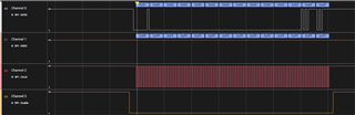

I am busy setting up SPI (slave mode) on a IWR1843BOOST board to prototype SPI communications we wish to do. I have read through the doxygen files as well as the test examples. To test my code, I have set up a STM32 Nucelo board as a SPI master. When using 3 pin mode (SPI_PINMODE_3PIN) my code operates correctly and I am able to read data from the master. However, when in 4 pin mode (SPI_PINMODE_4PIN_CS) the code either hangs, or times out depending if I include a transfer timeout or not. I presume the code is waiting for a HW signal that I know is being sent (confirmed with logic analyser - see picture below) and I am sure that I have the pinmux settings correct (see below). I am therefore at a loss as to why the 4-pin mode isn't working and am hoping someone on this forum can point me in the right direction? I will be happy to share more code as/if required.

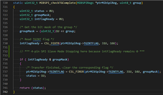

    It feels to me that maybe I have not set up the SPI pins correctly and the board is expecting a CS signal that I know is being sent, but perhaps isn't being handled correctly with my setup? If it helps, this is exactly where the code is stopping when it reaches "if ( intFlagReady & groupMask)" in mibspi_dma because intFlagReady remains zero (see below)

  • Hi Tim,
    I managed to get the 4-pin mode working. It seems that adding the below line to my SPI parameters fixed it for some reason.
    • spiParams.u.slaveParams.chipSelect = 1;

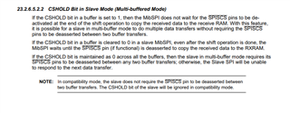

    Thank you for the reply. Have you looked into the TRM that I sent above? I was able to find information about setting a CSHOLD bit when in multi-buffered, slave mode. See page 2892 of the TRM and the picture below:
    This may not be what your looking for, but it might help to point in the right direction.
    Another thing to maybe try is putting a delay after the first 2 bytes are sent from the master. This may stop the code on the slave side from hanging after reading the first 2 bytes.

    Below is a picture of the 10 bytes of data I send from the controller (unfortunately we will likely not be able to toggle CS every 2 bytes).
    I initially do a SPI_Transfer call to read the first 2 bytes {0x01, 0x01} which works correctly, then I do a second SPI_Transfer call to read the remaining bytes {0x00, 0x00, 0x00, 0x00, 0x00, 0x00, 0xA5, 0xA5} and it times out. I use the same SPI_Handle (that isn't closed after the first transfer) to call the SPI_Transfer function each time as follows:
