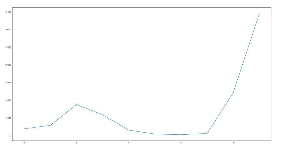

And I get this range profile(subject is about 40cm away from radar)
It can be seen that the amplitude of subject is about 35000

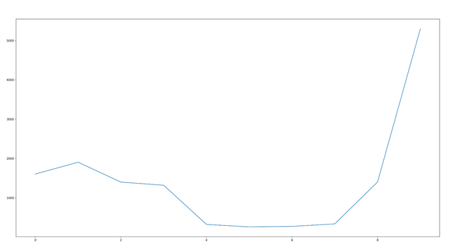

And I get  this range _profle in the same scenario
 the amplitude of subject is under 1000 ,it's much smaller than 35000(the former),  introduce a huge noise figure.
 Both the experiment have the same Rx gain(30db) and  other parameters,What drives the differences?
I try to achieve the same SNR as the former,how should I modify my config file ?
I also try to modify Rx gain to 48,the maxinum according to table5.23 in C:\ti\mmwave_dfp_01_02_06_03\docs\mmWave-Radar-Interface-Control.pdf.
The amplitude is higher than 1000 but still much smaller than 35000.

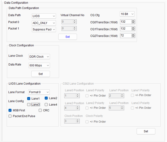

  • HI,  there:
    Please send me thconfiguration through the GUI capture.  So, it will be easier to compare it with the CLI configuration.
    Zigang
    this is my configuration of mmwave_studio.

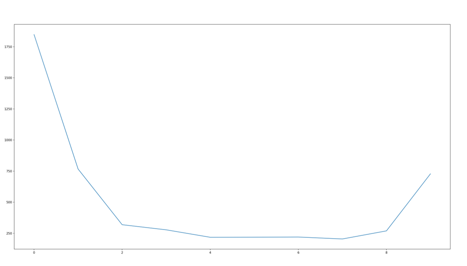

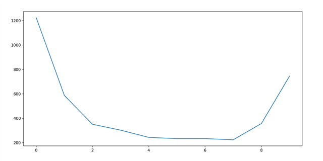

    But the results are similiar to before ,things didn't get better.
  • HI,
    So the scale may be different between the two applications.  But why the shape is also different? Do you have any ideas?  Are these figures generated from the tools? or by you?
    Zigang
    Thanks for your reply.
    The two experiments were performed in the same scenario.I haved tried many times but  result is the same.
    This is my test scenario and The radar didn't move.
    These images are generated from same python files and are the result of a 1D Fourier transform of raw_data
  • I see, so you are the one created the python file.   In that case, you need to understand the data format between RAW data from radar studio and from OOB demo are different.
    For radar studio, the data is I before Q, and I1, I2, Q1, Q2, I3, I4, Q3, Q4, ...
    For OOB demo, the data is Q before I, and usually is Q1, I1, Q2, I2, ...
    You can send me the json file that you used doing OOB demo data capture to confirm.
    Zigang
  • Oh!
    I modified my python file and problem was solved.Thanks a lot.

  • You can search inside the SDK users guide.   Search adcbufCfg, you can find that Q sample first is the only mode that supported by SDK OOB demo.
    In radar studio, you have option, but by default, it is I first.  Check your figure below.
