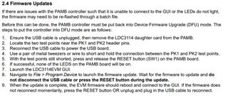

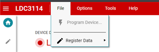

    If there are no LEDs on the PAMB, then the board is not running the firmware properly. You can try updating it via the GUI by going to file-> program device.
    If this option is grayed out as shown above, you will need to try putting the board in DFU mode first. Instructions for this are in the EVM user's Guide:
    Once the firmware has been updated and the PAMB restarts, two LEDs should be lit on the PAMB.

    I tried the firmware update once, without success. Now the button 'program device' remains greyed out. Since I tried this firmware update, all LEDs of the green motherboard are off, whether or not I have a cable connected to the pins PK1 and PK2.
    Do you have any further advice?
