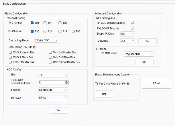

I use mmwave studio 2.1.1.0 to capture raw data from DCA1000 and IWR6843IWK,the process is as follows,and calculated range resolution is about 5.9cm
And I placed my laptop 36.5cm (about 7.5 * range resolution)away from the radar。
theoretically,In theory, rangebin7 should have stronger power
But I get this range_profile,why is this?
  • Hi Yuan,
    There are few things to consider here:
    • Due to the nature of FFT, it will not be able to accurately represent the frequency corresponding to the exact range due to limited resolution in the frequency domain.
    • There will also exist some leakage of energy into the neighboring bins which can be mitigated with windowing before applying the FFT.
    • The point of reflection from the strongest RCS on your laptop might also be at a slightly different range when compared to what you have measured.
    Based on this, you should be able to change some configuration such as FFT size, apply a window and obtain a more accurate range FFT. You can also use a corner reflector to fix your point of reference with lesser error.
