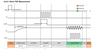

    The TDC1000 has a configurable echo listening window, where the devices internal comparator will enable and generate STOP pulses. My assumption is that perhaps you have the listening window enabled too early so it is triggering off of the excitation voltage to the transducer. I assume you may be using the Short TOF measurement since the distance is kind of small, so the main values to pay attention to would be SHORT_TOF_BLANK_PERIOD and the TOF_TIMEOUT_CTRL. Please refer to image below for measurement sequence and timing.

    It looks like you may be too zoomed out to see the data on the COMPIN line. You need to zoom in on the TX pulse and when you have an echo you should be able to see it during the listening window like the image below.
    One thing I noticed on your capture is that the voltages don't look correct on your scope. Vref on your COMPIN signal should be around 2.5V and TX pulses should be around 4V. I would check your probes/scope to make sure you don't have any issues there.
