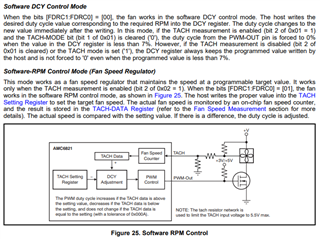

  • If you want to configure PWM directly in DCY register 0x22, you must configure FDRC=00 which is Software DCY mode.
    You are setting FDRC=01 Software RPM, which is controlled by writing to the TACH SETTING registers 0x1E, 0x1F.

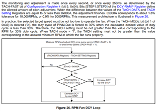

  • Higher TACH values correspond to lower fan speeds. The values you are writing may not correspond to a PWM > 30%.
    If the reported TACH-DATA does not reflect actual fan speed, then there must be a mistake in the configuration of the TACH-MODE, PSPR, or PWMINV for your circuit. If the actual fan speed is misinterpreted, it will prevent the AMC6821 from controlling fan speed in Software RPM mode.

  • The TACH registers have the following format:
    thanks,
    ren

  • What is the read back of DCY? If the DCY is 30%, then the AMC6821 believes the TACH SETTING is too low for the fan configuration.
    Are you setting START=1 as previously discussed?
    What is your fan circuit? If the TACH-MODE, PSPR or PWMINV is not correctly configured for your circuit, it will result in AMC6821 incorrectly measuring TACH. When the TACH is read incorrectly, AMC6821 will not be able to control fan speed in Software RPM mode.

  • Your TACH-MODE must be changed to 1 for your four-wire fan.
