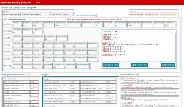

I have a question about calculating duty cycle when apply bpm and fineMotion.
Take the AoP_6m_ststicRetention.cfg as example, I expect the duty cycle will be ((30+59)*3*48*1000)/55=0.23. My question is that Is this value correct? Even if bpm is used.
channelCfg 15 7 0
adcCfg 2 1
adcbufCfg -1 0 1 1 1
lowPower 0 0
bpmCfg -1 1 1 2
profileCfg 0 60.75 30.00 25.00 59.10 0 0 54.71 1 96 2950.00 2 1 36
chirpCfg 0 0 0 0 0 0 0 1
chirpCfg 1 1 0 0 0 0 0 6
chirpCfg 2 2 0 0 0 0 0 6
frameCfg 0 2 48 0 55.00 1 0
fineMotionCfg -1 1 1.0 10 2
