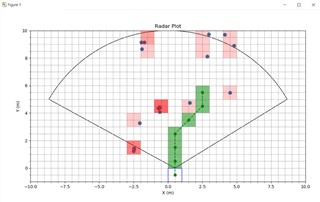

I am using TI mmwave radar AWR1642 in short range. Through data collection, I have observed that the radar provides detection up-to 10m range in depth(X axis). Another feature i observed is that the axis of radar is aligned so that the origin is at centre and x axis increases from zero to max, y axis ranges from positive max to negative max. While calibrating radar and camera
  1. should i shift the origin towards the side?
  2. what is the maximum detection range horizontally(Y axis)?
Note: On the image below,Image from, it shows that horizontal range is -8.5 to 8.5m that is approx 17m. Is this valid ?
Kindly help us to complete the radar camera calibration, if you feel that i am doing a wrong way to do radar camera calibration.

  • Hello Deepak,
    Radar would provide you with the range and angle information for each object. With this you can estimate the X and Y distance of the object from the radar sensor. The radar sensor would be the origin in this case.
