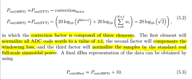

The unit for range FFT will be dBFS. Please refer to below e2e thread for more understanding.
Ankit
Hi Ankit,
I understand that the values are usually in dBFS.but without the correction factor mentions in that thread, the value doesn't become relative and cannot be represented as dBFS. Additionally the Pout value mentioned has already undergone a log conversion. Our request is about the unit before the log conversion.
I would like to redirect you to my comment above rather than the question here, which explains our need for the actual physical unit or the relation to the received antenna power, rather than the relative unit. Any help on this would be really appreciated.
Thanks in advance,
Santhana Raj
Hi Sanathan,
1. As Nathan pointed out the Range FFT samples are based off the ADC codes, which are then is converted to magnitude and relative power(dBFS).
2. The correction factor can be found out using,
Please refer to the below thread for understanding calculations of power.
Ankit
Hi Ankit,
We know this and we are not asking for this explanation.
Let me repeat my question.
We want to know the relation between the reflected wave power at the antenna input and the mV that is fed to the ADC input.
We do not want to know how to calculate dBFS. We do not want to know how ADC bit values are represented in dB or dBFS. We don't want to calculate the relative power. We do not want the relation to mV at antenna lines but at ADC input (after LNA, adaptive gain & mixers).
Hi Sanathan,
Below is an example calculation to get the amplitude level at the LNA input ->
If you are using 12bit ADC mode , a value of 0x7FF corresponds to positive peak value at the ADC input, which corresponds to 1V peak voltage at the ADC input. 1V peak corresponds to 10dBm power (50 ohms system , assuming sinusoidal signal). Now if the RX gain setting is 30dB , this means at the LNA input the power level is (10dbm -30dbm ) = -20dBm.
This way you can back calculate the LNA input for any corresponding ADC code word .
