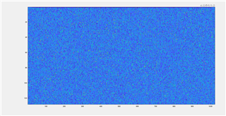

Hello, I'm having issues when capturing data with the DCA1000EVM and the IWR6843ISK. I need to take measurements with these devices and then save them to a MATLAB file. However, it's quite tedious because sometimes, when exporting it to MATLAB, the data gets "corrupted" and shows this response:
Let me describe the procedure I am following, first of all, configuring the DCA100EVM and capturing the data, with the commands below:

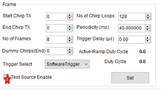

[16:09:50] [RadarAPI]: ar1.FrameConfig(0, 0, 100, 128, 13,83, 0, 0, 1)
[16:09:50] [RadarAPI]: Status: Passed

Then I am using a matlab code to call rawDataReader.m function
radarCubeDataFileName = "random_name"
ToSaveFolder="any_folder path";
setupJsonFileName = "C:\ti\mmwave_studio_02_01_01_00\mmWaveStudio\JSONSampleFiles\68xx\1024_config.setup.json";
rawDataFileName = "C:\ti\mmwave_studio_02_01_01_00\mmWaveStudio\PostProc\adc_data.bin";
ToSaveFolderAndFileName = strcat(ToSaveFolder,'\',radarCubeDataFileName);
rawDataReader(setupJsonFileName, rawDataFileName, ToSaveFolderAndFileName, 0);
After the procces I am getting again the noisy response in Matlab, this happen sometimes without a clear pattern so I cannot identify where is the problem.
