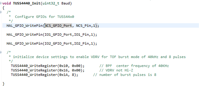

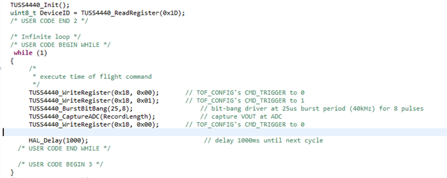

I have built a prototype using TUSS4440 . Am trying to configure the configure a clock of 40KHz in IOMode0 . I am unable to see anything at IO1 & IO2.
We have built a prototype board using TUSS4440 and using external ST Microcontroller Evaluation board for Programming.
Using this interface reading and writing of the Registers are being done properly with the SPI Mode 2.
Provided the Burst pulses of 8 every second at IO2 pin. There weren't any pulses generated at the pins OUTA, OUTB.
Attaching the firmware for reference.

    Can the customer provide a scope capture for the IO2 pin? Have they performed a read of the DEV_STAT register to see if the device reports a any issues after trying to drive the device?

    The DEV_STAT is read as 0 after driving the device by giving the pulses at IO2.

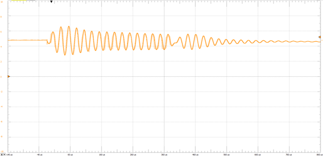

    I reviewed their schematic and I don't see anything majorly wrong with it, in fact it looks very similar to the TUSS4440EVM which I am able to get a signal out of the OUTA and OUTB pins that looks like this image below:
    My only comment would be on the VDRV capacitor, I would recommend using a larger capacitor currently they have a 0.1uF while the EVM uses 2.2uF. Does the customer happen to have a BOOSTXL-TUSS4440EVM? My concern is that perhaps they are not communicating with the device properly hence why they dont see any signals being generated by the device.
