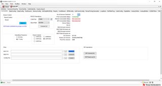

How can I work please with the EVK type IWR1843boost (by using my Laptop with Windows 11) ?
After I installed all the drivers, the device manager recognizes the EVK (see below "Port (COM&LPT)").
Then I installed the mmW-Studio software, but this software does not recognize the EVK (see below "mmWave Studio 2.1.1.0").

    What are you trying to do? mmWaveStudio is for raw data capture of the raw IF signal straight from the ADC buffer using a mmWave Sensor + DCA1000. Is this what you are trying to do? If so what is the error which can be seen in the Output tab

  • No error is received. IWR1843BOOST is not recognized by the mmW-Studio. Although from the TI's platform in the cloud, the IWR1843BOOST is recognized.

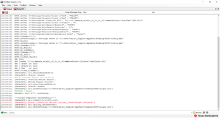

    After clicking any button in mmWaveStudio, a LUA command is sent and you can check the Output tab to see what the resulting line sent was. Please send a picture of the Output tab after trying to connect to RS232. Pictures of your setup would be a start here. It will allow me to see the switches on the EVMs. With a DCA1000 you will need to ensure that a 5V 3A power supply is being used. Offline help can happen if you reach out through your TI representative/field applications engineer.

    Please see below:
    ConnectTarget returning 3 is a very common connection error, usually due to incorrect hardware setup. Based off of your EVM pic, SOP0 and SOP1 needs to be set to ON.
    The switch that has SPI and CAN needs to be set to the SPI side as well.

    We tried to view the signals from the IWR1843Boost. We succeeded to load the BSS and MSS files into the board, but the SPI shows error, and the program does not start. Can you please help with this problem? Please s ee the attached MP4 and JPG files

    The FW selected is correct, and hardware switches are correct but where is the DCA1000 in your picture? mmWaveStudio is for mmWaveSensor + DCA1000.
