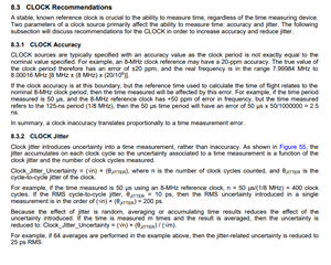

    You can read them at section 8.3 of the datasheet. Here is a snippet of that section:
    Have you tried reducing the amount of calibration cycles to see what kind of effect it has on your measurement?

  • have you taken a look at this list yet to see if your current 10MHz clock meets some of these guidelines?
    I hadn't looked because I was confident I had a pretty good clock. The accuracy and jitter specs are better than the figures in the example calculations in that section, so I don't think that those factors are contributing significantly.

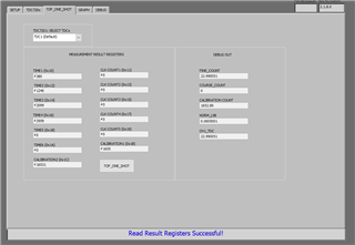

  • Hi Isaac, I have tried to replicate the issues I described above using the EVK. I first tried the 1Hz pulse into TDC1 START and a 10 MHz square wave into STOP, using the local/onboard 8MHz reference oscillator. This worked OK but not every time I requested a measurement through the GUI - TIMEn registers often read 0x0. When it did work I got sensible numbers for TIMEn and the calibration resolution looks sensible (~0.06 = 60 picoseconds).
    Then I moved to a higher speed clock for STOP that is the same as my application and also the same 10 MHz external reference input that I am using on my own board. This also produced sensible values but again, didn't reliably produce readings each time they were requested - it often showed no response in the post-measurement register values, as far as I could read on the GUI.
    In summary, the behaviour was not perfect but I could not reproduce the issue described above. Please let me know what else could we look at.
