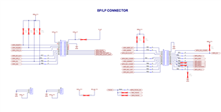

I am working with a IWR6843AOPEVM Revision G for a people counting application, and it works with UARTs over USB and I can visualize the data. I was trying to get the same data over UART pins in the 60-pin HD connector. I set the switch configuration based on the EVM user guide. The problem is the pinout of 60-pin connector on the EVM user guide shows only one pair of pins (RS232 TX/RX) as serial communication pins. I wanted to ask how can I get access to both the Data UART and Control UART using the 60-pin connector?
