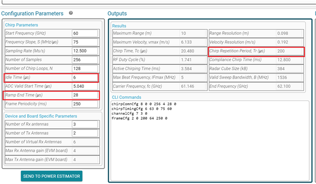

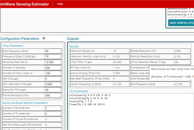

    The formulation you described doesn't come the same way in the app.
    I tried with the MotionDetect.cfg in the Sensing Estimator tool and auto-populated the fields.
    Here Tr=200
    Idle Time=6
    Ramp end time=28
    Tx=2
    Expected Tr= 2*(6+28) which is not equal to 200
  • Hello Aditya.
    In 6432 SDK, we have two chirping modes: (1) normal mode, (2) burst mode. Please refer to 'Section 3.1.3 Frame Configuration' of the 'MotionPresenceDetectionDemo_TuningGuide.pdf' for more details. You can also refer to 'Section 4 Chirp Configuration Modes' of the 'MotionPresenceDetectionDemo_documentation.pdf'.
    In normal mode, we only have 1 burst (which is the limit), where each chirp in the burst is uniform in time (i.e., idle1 = idle2). In this case, the chirp repetition period formula is valid (numTxAntennas*(idle + ramp)).
    But in burst mode, we have multiple bursts, where each burst has numTxAntennas chirps (which is the limit). In this mode, the chirp repetition period becomes equal to the burst period, which is configured in 'frameCfg 2 0 200 64 100 0'. In this mode, idle2 is still the same one configured in 'chirpTimingCfg 6 32 0 40 60.5', but idle1 is internally computed by 'burstPeriod - idle2 - numTxAntennas(ramp)'. These are explained in the documents above.
    The mmWave sensing estimator explains the meaning of chirp repetition period for normal mode, but it internally computes the correct value depending on the configured one.
    I hope this answer makes it clear. Please let us know if you have further questions.
