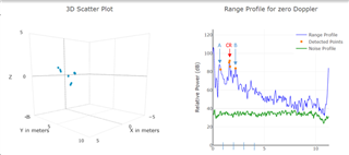

1) how do I know if the noise created by the clutter is low enough? Are there quantitative criteria for judging?
2)The figure below is the range plot in my test environment of calibration. The corner reflector (CR) is located 1.8m in front of the sensor. CR is the peak of the direct path reflection of the corner reflector which range is 1.8m. However, there is also a peak A at 0.7m and a peak B and 2.2m which source is unknown. Can I set a search window of 0.2m with a command like below to filter out peak A and peak B to get a reliable calibration result?
measureRangeBiasAndRxChanPhase 1 1.8 0.2
    This will be up to your discretion.
    You may, but I would recommend redoing this in a location that is less cluttered to get a more reliable result. You should only see one peak in the range-profile plot.
