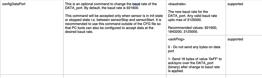

    I want to understand if I can get the information from the AWR1642BOOST UART without the DCA1000. I don't have access to a DCA1000 so am hoping the data will be available in the slow data path.
    Additionally, based on your question above, the DCA1000 is used to capture the ADC data streamed over LVDS and send it via ethernet for further processing. UART on the device is only meant to stream out smaller data packets such as detected point cloud and streaming out the entire ADC data would not be possible. UART has a max baud rate of 921600 as we use in our demo.

    I see that mmWave SDK user guide mentions different UART baud rate options for application to stream object data.
    So you need to calculate data rate and size requirement by yourself if your requirement can meet at max UART baud rate possible. Else you can opt other interface available SPI, CAN or stream over DCA1000 (LVDS->Ethernet).

  • Hi Gareth,
    Going by your calculations, a rate of ~(1200 Bytes + Header/Extras) per frame for your application is supported by UART (with default dataport baud rate config).
