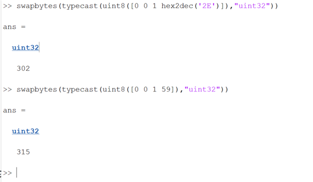

    I went through the c file to get the tlv type information.
    For the first frame, everything gets mapped correctly except the presence detection:
    Raw Data uint8:
    59        1        0        0        2        0        0        0        4        0        0        0        0        0        0        0        2        1        4        3
    Insights from data:
    Type =59        1        0        0 =315 = MMWDEMO_OUTPUT_EXT_MSG_ENHANCED_PRESENCE_INDICATION
    Length= 2        0        0        0 =  2
    But the length of the Presence Detection Type: 1021, Length: 4 Bytes and not 2 bytes
    Why the Length of the payload in Bytes is given as 2 bytes?
    If in case you need the entire data, here it is:
    2 1 4 3 6 5 8 7 2 0 2 5 96 1 0 0 50 100 10 0 93 12 0 0 0 0 0 0 0 0 0 0 3 0 0 0 255 255 255 255 47 1 0 0 0 1 0 0 4 42 1 0 84 15 1 0 72 3 1 0 142 41 1 0 250 44 1 0 1 43 1 0 57 59 1 0 159 77 1 0 94 81 1 0 180 61 1 0 154 41 1 0 234 25 1 0 196 15 1 0 103 244 0 0 159 200 0 0 66 219 0 0 129 244 0 0 24 233 0 0 138 213 0 0 240 219 0 0 181 20 1 0 215 58 1 0 252 28 1 0 86 233 0 0 103 240 0 0 101 43 1 0 53 73 1 0 110 27 1 0 225 247 0 0 10 249 0 0 230 4 1 0 82 2 1 0 237 13 1 0 40 7 1 0 10 10 1 0 33 23 1 0 81 4 1 0 153 21 1 0 84 7 1 0 124 39 1 0 209 51 1 0 43 27 1 0 24 12 1 0 72 14 1 0 197 251 0 0 226 15 1 0 12 51 1 0 247 63 1 0 148 71 1 0 76 60 1 0 206 37 1 0 28 31 1 0 88 35 1 0 9 27 1 0 134 252 0 0 246 4 1 0 103 39 1 0 219 48 1 0 250 11 1 0 208 252 0 0 65 240 0 0 163 241 0 0 85 243 0 0 33 230 0 0 50 1 0 0 24 0 0 0 0 0 0 0 0 0 0 0 255 255 0 0 255 255 255 255 41 0 44 0 44 0 32 0 59 1 0 0 2 0 0 0 4 0 0 0 0 0 0 0 2 1 4 3
    With regards to the TLV information for 302, we are actually updating documentation for that which should be released within the next week. It will give more detailed information about all the TLV's. I will link it once it goes public.
    Can you show me how you got 315 as the type # for the TLV? Remember the byte order we received the data in before. I don't believe the type is 315.
    Tim
    Please see the below workflow.
    Like your earlier workflow, I did the same.
    Please note, the data Type =59        1        0        0  is in uint8, as mentioned above.

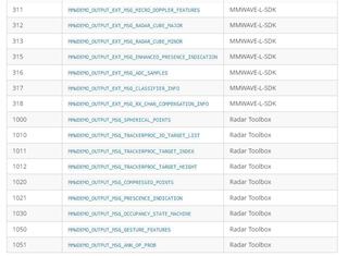

  • Hi
    Can you give the mapping for the below TLV type in regards to IWRL6432
    Type Identifier Value Type Condition for output
    1 Detected Points <detected objects> is set to 1 or 2 AND there are detected objects for the frame, else this type is not sent for that frame
    2 Range Profile <log magnitude range> is set to 1; occurs every frame
    3 Noise Floor Profile <noise profile> is set to 1; occurs every frame
    4 Azimuth Static Heatmap <rangeAzimuth(Elevation)HeatMap> is set to 1 AND demo is not for AOP or ODS which use AOA2D; occurs every frame
    5 Range-Doppler Heatmap <rangeDopplerHeatMap> is set to 1; occurs every frame
    6 Statistics (Performance) <statsInfo> is set to 1; occurs every frame
    7 Side Info for Detected Points <detected objects> is set to 2 AND there are detected objects for the frame, else this type is not sent for that frame
    8 Azimuth/Elevation Static Heatmap <rangeAzimuth(Elevation)HeatMap> is set to 1 AND demo is for AOP or ODS which use AOA2D; occurs every frame
    9 Temperature Statistics <statsInfo> is set to 1; occurs every frame
    Please allow me a couple days to give you complete information. We are releasing a new version of the toolbox with updated TLV's for IWRL6432 in a couple of days. I will post here as soon as I have information.
    In the meantime, here is a list of some of them
