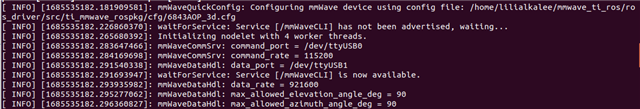

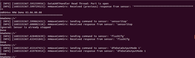

    Excuse my lack of attention, I found the correct Readme and flashed the correct out-of-box demo which gave no error as you can see in the screens bellow (modified the ports in the .launch file to corresponding ones).

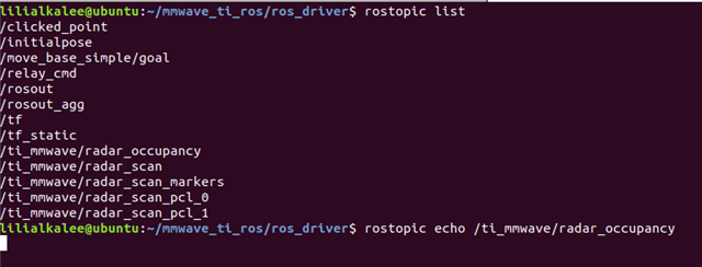

    Once done, I can check the topics list which are all available. When I try to print their values, I have three results :
    1- I either get a pending terminal as shown here :
    2- I get a warning for the scan_pcl topics :

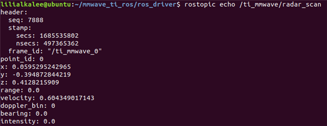

    3- The only topic printing real time values is radar_scan, I can even see the changes by passing my hand next to the radar, when nothing is detected, the printing stops :
    PS : in the launch terminal, I get no error at all when printing topics.

    You can ignore the other topics, the other ones exist for purely debug purposes. As long as you are getting the point cloud from one of the topics then you are getting the full point cloud based on the configuration file's chirp design.
    The binaries you find in the ROS driver's bin folder are all default binaries found throughout the Radar Toolbox, I have put them in one place for the user's convenience. The way it works is that the binary flashed to the sensor configures the output to send out TLVs and the mmWave + serial ROS packages read in this output. A list of all the TLVs that are/can be output can be found here
     https://dev.ti.com/tirex/explore/node?a=1AslXXD__1.00.01.07&node=A__ADnbI7zK9bSRgZqeAxprvQ__radar_toolbox__1AslXXD__1.00.01.07
    You can have a ROS topic for every TLV found above if you want any other types of data. Currently what is implemented in the ROS driver is the Detected Points TLV. I would look particularly at the DataHandlerClass.cpp file in the ROS driver's source as that is where a majority of the output parsing for ROS occurs.
