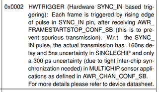

  • Hi Josh,
    I wonder if it is possible to use the GPIO of the 6843 itself (either on MSSro DSS) to trigger the SYNC_IN? If this is possible, then by controlling the GPIO we can achieve a software triggering. (of course, we will have to customize the PCB board)
    Another issue is that although there are many people discussing the Hardware-triggering mode, I found that the user's guide for the mmwaveSDK (3.6.0 LTS) says that only software triggering mode is supported (p. 24 in frameCfg):
    Before we move forward, I would like to check if this is just a mistake in the SDK user's guide or if the IWR6843AOP doesn't actually support this feature.
    Thanks in advance.
    Po-Chih Chen

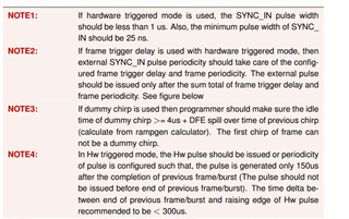

    I have tried to use ICBOOST to test out this function. Here's the setup:
    1. Move the 0 ohm from R346 to R348 position to allow access to the SYNC_IN pin
    2. Change the frameCfg to "frameCfg 0 2 32 1 100 2 0" (1 for one frame and 2 for the hardware trigger)
    3. I trigger the SYNC_IN pin using a GPIO
    However, the sensor doesn't function at all. Are there any requirements for the trigger pulse? I would like to know where can I find some more details about the hardware trigger because there it's not mentioned in the SDK User's Guide.
    Po-Chih Chen
    Please refer to the Interface Control Document. Table 5.26 and the notes below the table provide some timing information.
    Josh
  • Hi Po-Chih,
    I wanted to give you an update since I got a response about the note in the SDK on software trigger being the only supported option. This note was included because the HW trigger mode was not tested within the context of the SDK. A use case such as this was not considered, typically the HW trigger is more suited in the cascade configuration which is connected in the daisy chain mode and secondary devices are triggered via the Sync_In pulse of the primary device and so on..
    If you have no further questions I will close this thread. Please do not hesitate to create another post if additional questions come up.
