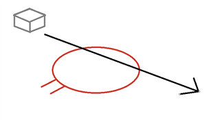

    Our target will move laterally past the sensor at a height variable between 20 - 10 mm (as crudely depicted below). Would you recommend a circular PCB coil then? I thought a wirewound coil would have the added benefit of a larger amount of windings at a larger diameter (not coiling inwards as much as a PCB coil) - and thus a larger sensing distance. OR would a racetrack or other shape have a benefit in this situation?

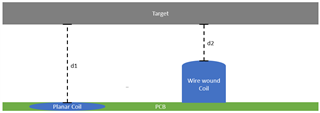

    What I mean is, if your wire wound coil sticks up from the PCB, it reduces the sensing distance between the coils and the target compared to a planar coil:
    However, if this is not the case then the diameter of the coil is the main factor to increase the sensing distance.
    And since the magnets are below the coil, shielding and increasing the sensor size may be best. One factor to consider is the size of your target in relation to your sensor coils. This E2E post has more information on the impact of different target sizes. If your target is still around the size of your 40mm coil or larger, then there shouldn't be any issues.

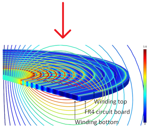

    We're in a bit of a tough design space though, as we are trying to detect a small metallic ring (OD 11mm, ID 10mm, h 4mm) at a distance in the range of 15 +/- 5mm (measured from the PCB; any components with z-height should protrude downwards). That's why I'm trying to understand what other parameters there are to optimize our sensing distance. Is the number of windings in no way a factor for this?
    In addition, where over the (spiral) coil is the sensing distance the furthest? Would that be right between the ID and OD of the windings (i.e. at the red arrow as drawn below)? Are there different topologies of coils that we should consider for further sensing?
    Tal Amram
    For a ring, I think it is best to stick with a circular sensor coil. One issue with using a ring shape as the metal target is that the coupling between the sensor coils and metal are less than a uniform target. Similar to how the target size matters, the hole in the center can lead to less change in inductance. The best placement is to center your target over the center of the coil.
    The inner most windings contribute very little to the magnetic field generated by the sensor coil which is why the number of windings does not have a significant impact on sensing distance. The outer diameter is really the only thing that makes a significant change in the sensing distance.
