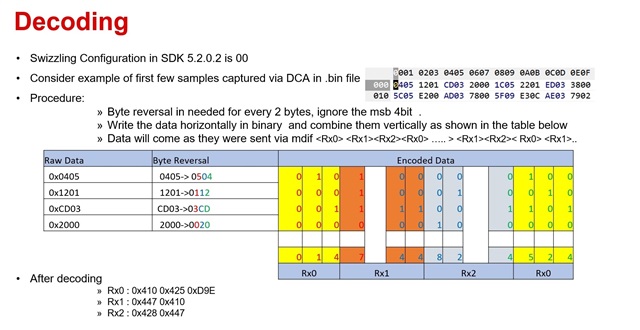

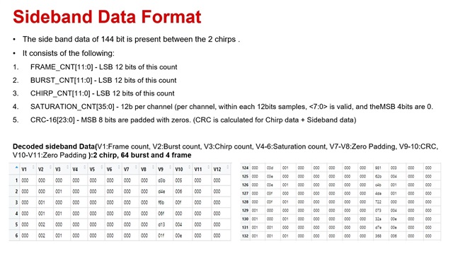

    Were you able to decode the packets? You need to first check for the sideband data
    Once the side band data is found to be correct then you can extract the chirp data
    If you find that sideband data is split, try  to capture with another windows machine. Sometimes the ethernet driver of the PC splits the packet such that sideband dats is broken

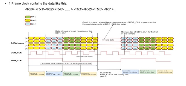

    We have a r script which decodes the data collected in DCA1000 while running the SDK 5.2. The script takes the .cfg file as the input along with the log collected in DCA1000. The script allows you to select the frame/burst/chirp and displays the data for the selected chirp

    ##########################sideband_data############################
    mdif_sideband <- function()
    SideBand_data = array(0, dim = c((chirps-1), N_bits))
    SideBand_data_hex = array(0, dim = c((chirps-1), N_bits))
    temp_array = array(c(0, 0, 0, 0))
    rx_val = array(0, total_samples)
    for (k in 1:(chirps-1))
    sideband_data[k,]=input3[(1+(k*N_samples*N_rx)+(12*(k-1))):((k*N_samples*N_rx)+12*k)]
    for (s in 1:(chirps-1))
    input1_2bytes = as.hexmode(sideband_data[s,])
    count1 = 0
    for (i in seq(1, N_bits, 4))
    temp_array[1] = input1_2bytes[i]
    temp_array[2] = input1_2bytes[i+1]
    temp_array[3] = input1_2bytes[i+2]
    temp_array[4] = input1_2bytes[i+3]
    for (j in N_bits:1)
    temp0 = bitwAnd(temp_array[1], 2^(j-1)) / 2^(j-1)
    temp1 = bitwAnd(temp_array[2], 2^(j-1)) / 2^(j-1)
    temp2 = bitwAnd(temp_array[3], 2^(j-1)) / 2^(j-1)
    temp3 = bitwAnd(temp_array[4], 2^(j-1)) / 2^(j-1)
    temp_val = as.hexmode((temp3 * 8) + (temp2 * 4) + (temp1 * 2) + temp0)
    count1 = count1 + 1
    rx_val[count1] = temp_val
    p=1
    for (i in seq(1, (N_bits * 3), 3))
    temp_rx_val = (rx_val[i+2] * 256) + (rx_val[i+1] * 16) + rx_val[i]
    SideBand_data[s,p]= temp_rx_val
    p=p+1
    SideBand_data_hex[s,]=format(as.hexmode(SideBand_data[s,]), width = 3)
    return(SideBand_data_hex)

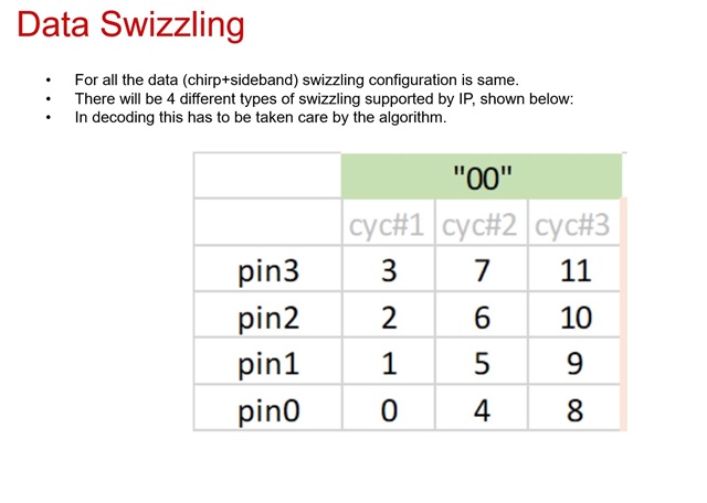

    Below is the explanation for decoding of data
