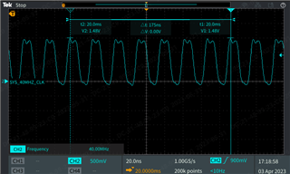

In case of DC coupled and 1.8V VIOIN, the OSC_CLKOUT signal is 1.56 Vpp which is more than 1.3V.
Futhermore, 1.56 Vpp will exceed the max input level 1.2 Vpp when AC coupled.
Is there anything wrong?
BR
Lei Tao
