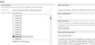

I design AWR1843 board, and ready to JTAG port for XDS110 as following AWR1843BOOST.
 - JTAG connection port to XDS110 from AWR1843 : AR_TMS(N10) / AR_TCK(P10) / AR_TDO_SOP0(N13) / AR_TDI(R11) / AR_NRST(R3) / 3.3V / GND
But, It doesn't work at CCS tool.
I got the log file after Test conntion in CCS. Please let me know which port is EMU[0] and EMU[1] of the AWR1843.
Thanks.
-----[Print the reset-command hardware log-file]-----------------------------
The scan-path will be reset by toggling the JTAG TRST signal.
The controller is the XDS110 with USB interface.
The link from controller to target is direct (without cable).
The software is configured for XDS110 features.
The controller cannot monitor the value on the EMU[0] pin.
The controller cannot monitor the value on the EMU[1] pin.
The controller cannot control the timing on output pins.
The controller cannot control the timing on input pins.
The scan-path link-delay has been set to exactly '0' (0x0000).
-----[An error has occurred and this utility has aborted]--------------------
This error is generated by TI's USCIF driver or utilities.
The value is '-233' (0xffffff17).
The title is 'SC_ERR_PATH_BROKEN'.
The explanation is:
The JTAG IR and DR scan-paths cannot circulate bits, they may be broken.
An attempt to scan the JTAG scan-path has failed.
The target's JTAG scan-path appears to be broken
with a stuck-at-ones or stuck-at-zero fault.
[End: Texas Instruments XDS110 USB Debug Probe_0]
